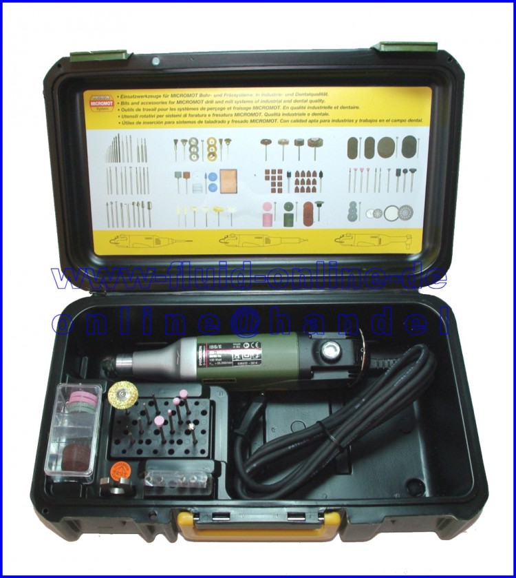

I'm considering buying one of the following Proxxon rotary tools for use as my ShapeOko spindle:
http://www.proxxontools.com/store/pc/vi ... roduct=206
http://www.proxxontools.com/store/pc/vi ... product=13
The first model with the cast aluminum head claims a max. runout of 0.001".
Is anyone else using these or does anyone have direct experience with Proxxon tools? Would one make a decent long-term spindle? The only disadvantages I see are higher price and potentially top-heavy weight distribution.

There is a new model of the ib/e for 2012, an ibs/e, with a new motor - it has a grey motor casing instead of the old yellow one.
When the motor brushes go on the ib/e (ibs/e), the speed electronics often go with them. Perhaps regular motor bushing replacement would be prudent - though at what interval I don't know.
Despite this, the robustness and accuracy of the tool seems to be the best out there, ib/e's are retrofitted to replace the spindle on expensive Roland machines and perform far better than the original.
The other point of interest is that the bearings on Proxxon rotary tools will still wear and can be replaced - even replaced with long life ceramic bearings which have been specially made in china for the ib/e (ibs/e) tools giving far greater bearing life.
Finally there are two ways to buy this premium Proxxon tool, in the retail packaging with case and accessories or as an industry item with just the tool on its own - this last way drops the price by about 15% I was told.
